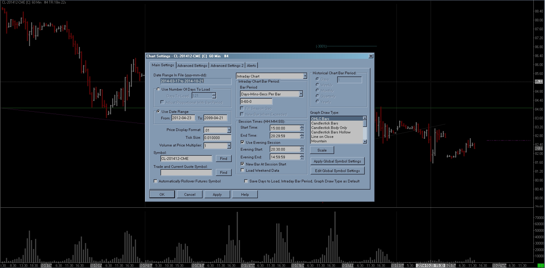

I assume this is broken since 1202.
Please refer to the picture attached.
For the CL (crude) Pit Session the bar should start 15:00 (CET) not 15:30
(see chart in the background with time at mouse cross-hair )
The evening/overnight session should start 20:30 (cet)
If I recall correctly, this worked before in sierra.

[2014-10-22 09:24:50]
Paul.M - Posts: 115
Do you plan to correct this in the future ?
"backward alignment" makes no sense for a trader.
From a traders perspective , the current handling creates a false picture of the Pit session.
The pit session is 15:00 - 20:30 cet
the overnight is the rest (20:30 - 15:00 cet)
Also, sierra generally has trouble with the weekend break in regard to session times.
I understand sierra works correctly for only the PIT session slice,
but CL is heavily traded overnight.
There are many markets with similar session breaks (Pit + overnight time),
but different start/end times (not at top of the hour).
So not only crude would benefit from this.
please give it a thought to optimize this in future versions.
TY

Paul.M - Posts: 115
hi crazybears,
I have the same session times.
Mine are in CET (central europe time) - I think yours are eastern time (New York)

[2014-10-23 10:07:37]
Paul.M - Posts: 115
hi crazybears,
thank you for your help.
yes I did see the second - my precise settings are:
Pit: 15:00:00 - 20:29:59 CET
overnight : 20:30:00 - 14:59:59 CET
so I use a second early, you use a second late.
I tried your settings (except; I did not change my PC clock) - still the 60min Bars are wrong.
They are "back adjusted" and start at xx:30 - not at xx:00 during PIT.
Do your 60min bars start at top of the hour during Pit and at half the hour during overnight ?
(this is what institutional apps like CQG do - at least as an option)
I want 60min bars to start at top of hour during PIt and
I want the other 60min bars to start at xx:30
TY

[2014-10-23 19:44:30]
Paul.M - Posts: 115
hi crazybears,
yes I did reload multiple times,
Please see my picture, my pit session starts NOT at the top of hour.
also, if you are right and your picture suggests so :) - the 1st reply from support seems to contradict this.
still waiting for their reply.
image2014-10-23_213429.jpg / V - Attached On 2014-10-23 19:44:03 UTC - Size: 453.75 KB - 601 views
