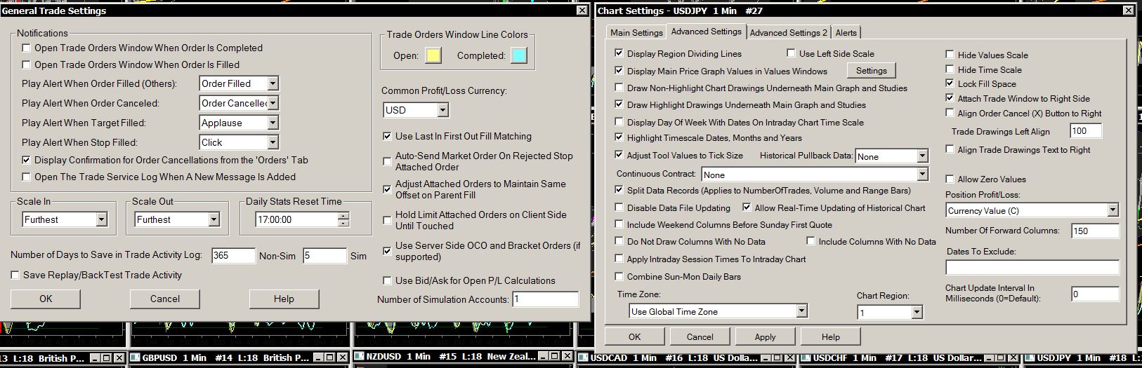

I know I have posted before, and wish I could get it worked out without another post, but I am still running into very weird issues regarding trading forex and then reviewing the results in the Trade Activity Log. I have the calculate in USD set, the Currency Value set, etc, but the math is so far off it is funny. I previously thought it was only related to JPY pairs, but recently saw a huge shift (like $5 became $9,000) trading some AUD pair. It was a few weeks ago...

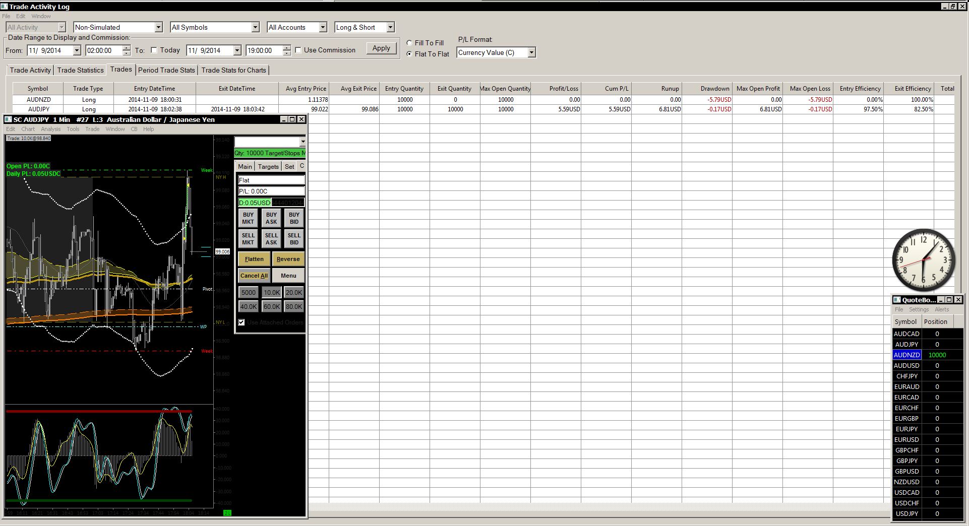

GaryD - Posts: 61
Ticket ID: 1413928102217
imageAUDJPY P&L example.JPG / V - Attached On 2014-11-09 23:12:57 UTC - Size: 332.32 KB - 537 views

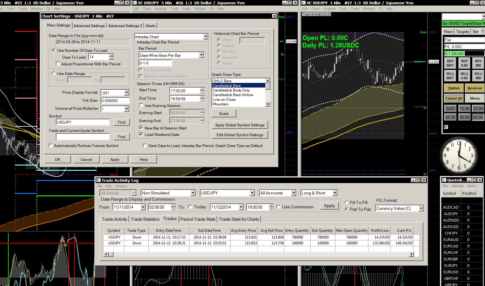

GaryD - Posts: 61
Here is a screenshot of a similar issue this morning in the USDJPY pair.
imageusdjpy.JPG / V - Attached On 2014-11-11 09:03:35 UTC - Size: 313.07 KB - 554 views

This is what it is set to
imageunchanged.JPG / V - Attached On 2014-11-11 10:49:09 UTC - Size: 205.54 KB - 531 views

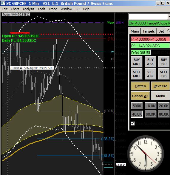

GaryD - Posts: 61
To make a direct comparison, here is the P&L reporting with the pound swiss trade. There is something wrong in the JPY pairs.
imagepound swiss with P&L reporting.JPG / V - Attached On 2014-11-11 11:04:15 UTC - Size: 210.67 KB - 565 views

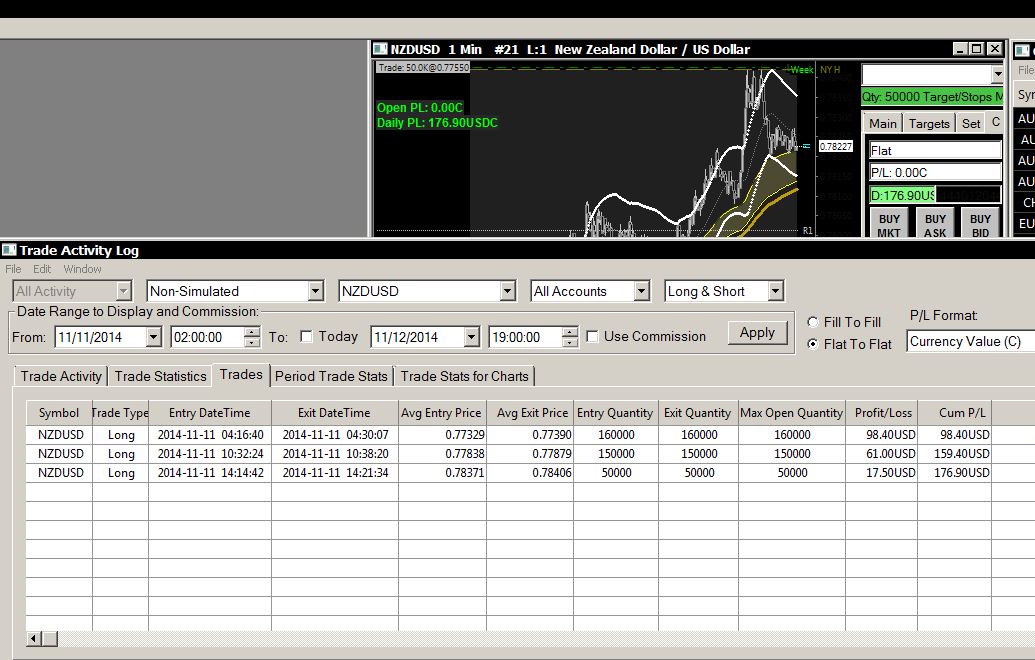

GaryD - Posts: 61
Kiwi trade also calculates correctly. It is only any pair that crosses with the JPY, but there is a problem.
imagekiwi.JPG / V - Attached On 2014-11-11 19:57:37 UTC - Size: 142.81 KB - 513 views

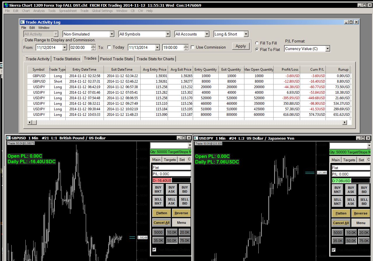

[2014-11-12 17:00:01]

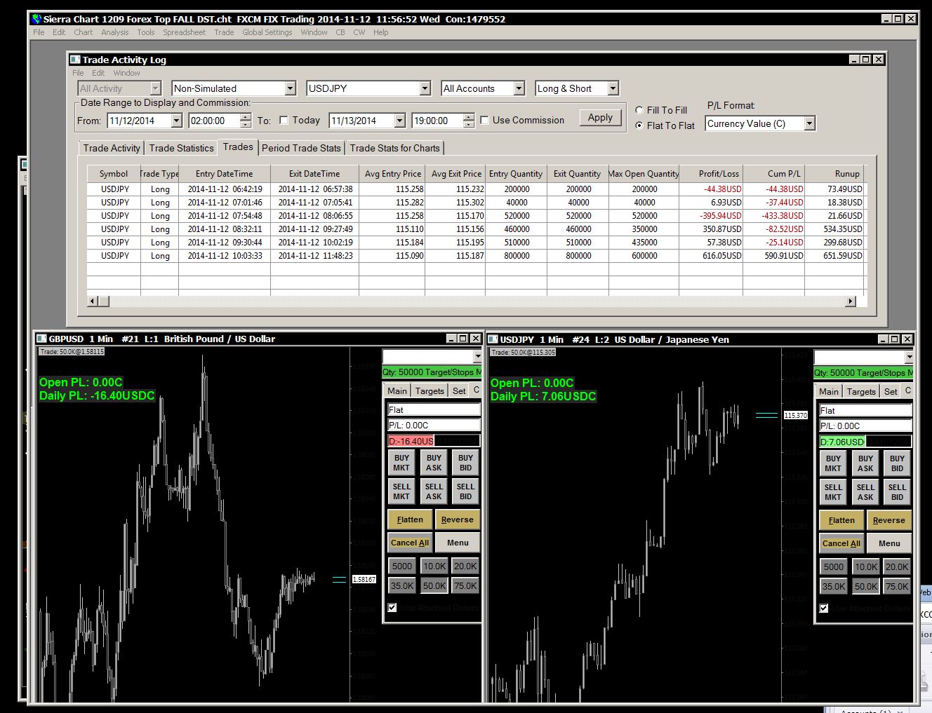

GaryD - Posts: 61
same settings, same install, same day... but put "JPY" on it and it is not working
imageyen.JPG / V - Attached On 2014-11-12 16:59:06 UTC - Size: 242.56 KB - 522 views
imagepound.JPG / V - Attached On 2014-11-12 16:59:13 UTC - Size: 226.56 KB - 603 views
imagepound versus yen.JPG / V - Attached On 2014-11-12 16:59:19 UTC - Size: 244.06 KB - 517 views
[2014-11-13 00:18:46]
You need to update to the latest version of Sierra Chart which is 1211. That has this option: Load Order Fills for Current Day Only in Chart Settings.
Help topic 81:
http://www.sierrachart.com/index.php?page=doc/helpdetails81.html
It explains why you see what you do. There is no program bug. It only has to do with order fill matching and missing fills.
