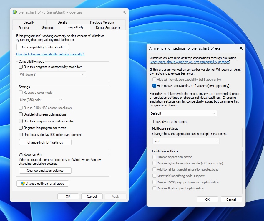

| ForgivingComputers.com - Posts: 1256 |
This is interesting. We wonder what the issue is preventing the X64 version of Sierra Chart running on Windows running on an ARM64 processor.
I found the new features can be disabled. Right-click on the SierraChart_ARM64.exe file Properties>>Compatibility>>Change Emulation Settings and then check the box for Hide Newer Emulated CPU Features (x64 apps only) https://learn.microsoft.com/en-us/windows/arm/apps-on-arm-program-compat-troubleshooter Date Time Of Last Edit: 2025-12-15 01:57:30

| [2025-12-15 16:13:03] |
Thank you for post #13. We would like to know, if this solves the problem for the users using the X64 version, on a Mac with Parallels and Windows.
I was able to start the application and load one of my custom studies. The only issue, which is probably unrelated, is that Update Current Version installs 2813. |

| [2025-12-31 19:47:37] |
I’ve stopped all updates as well with parallels. So afraid the custom studies won’t work as well.
You didn't say if you tried to change the Compatibility Settings for the ARM.exe: I found the new features can be disabled. Right-click on the SierraChart_ARM64.exe file Properties>>Compatibility>>Change Emulation Settings and then check the box for Hide Newer Emulated CPU Features (x64 apps only)
