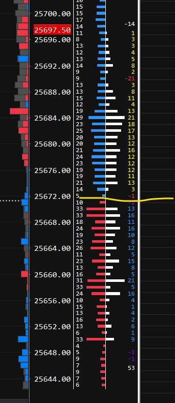

Actually, upon further review, I am still confused. See the attached file. The the crude yellow line is the current price. Everything above the line adds up to much more than -14, and everything below it is much more than 53. Am I not looking at this right?

John - SC Support - Posts: 48597
To be certain you have everything updated and viewing all the consistent data, select "File >> Disconnect". Then look at the values for the Pulling/Stacking and add them up. They should match - we just double checked this and it is working properly for us.

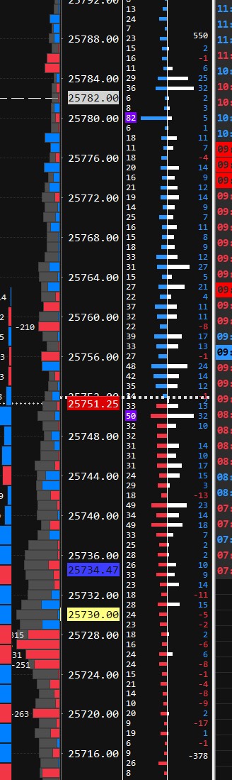

Please see the attached file. The numbers above the price add up to +358 and -15 for a total of 343. The numbers below price add up to +239 and -85 for a total of 154.
I can't figure out how the totals show +550 and -378. The total of all the negative numbers in that range is only -100. Could those be the total pull/stack numbers from the entire depth? Otherwise I'm not sure.

[2025-12-05 19:16:42]
Please do the following for us. Instead of using a single column for both Bid/Ask, please add the separate Pulling/Stacking Bid/Ask columns to the chart. Then after you have some data built up in those columns select "File >> Disconnect" then take an image so we can see the data in both columns along with the totals. We will then see what is occurring from there.

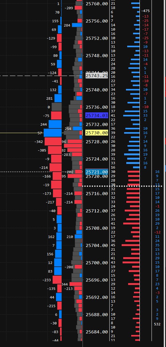

See attached with the separate columns.

[2025-12-05 19:47:06]
On the "Trade >> Chart DOM Settings" window, what are the following items set to:
- Max Bid/Ask Depth Pulling/Stacking Levels
- Limit Maximum Pulling/Stacking Value to Current Depth Quantity
- Add Trade Volume to Pulling/Stacking Value for Price

[2025-12-05 20:24:59]
Somehow the setting for "Chart >> Chart Settings >> Market Depth >> Maximum Market Depth Pulling Stacking Levels" is causing an issue for the totals of the pulling/stacking data. We will have to look into this, but everything is focused on getting the new tabs and title bars changes done, so this may take a bit before we can get to it.
The workaround for now, is to not limit the data using that Chart Settings option. If you use the setting for "Trade >> Chart DOM Settings >> Max Bid/Ask Depth Pulling/Stacking" then you will get the correct sums.
