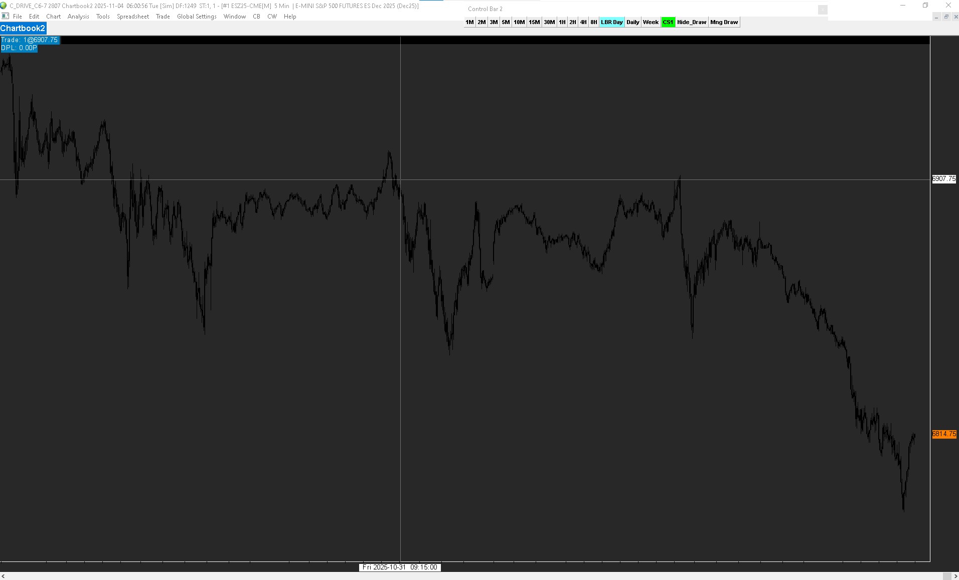

If I try to upgrade my Nvidia drivers above 572.6, then I get glitchy charts with Open GL (blacking out bars and studies as I move the mouse), only with chart trading mode enabled.
I had stayed at 572.6 (FEB2025), but I decided to try again, hoping it would improve. However, the problem persists when I go above 572.6. It's no big deal, and I can work around it (disable OpenGL on my trading instance or stick with 572.6).
However, is it a known problem, something I can easily fix or something that Nvidia Quadro drivers introduced after 572.60?
Attached images to show the problem (incidentally, I dont actually trade off these uploaded charts full of graphics, I use a separate clean instance - but that has the same problem if I use OPen GL)
Private File
Private File

New chart> new chart book>no studies>chart trade mode enabled = problem remains (albeit it's harder to trigger the fault)
New chart>new chart book>no studies>chart trade mode disabled = no problems
Toggling the Compatible OpenGL Profile on or off and restarting makes no difference to the above.
Further info:
I can also replicate the problem on my existing charts without chart mode enabled if I resize a rectangle on the charts that have numerous studies, overlays/colour bar studies, and this happens (almost) every time I resize a rectangle.
It is more challenging to replicate the same issue on the new single test chart, but with studies added, it can occur after 4-6 attempts to resize a rectangle.
I'm unable to replicate the problem with the new single chart without studies, regardless of how many times I resize the rectangle.

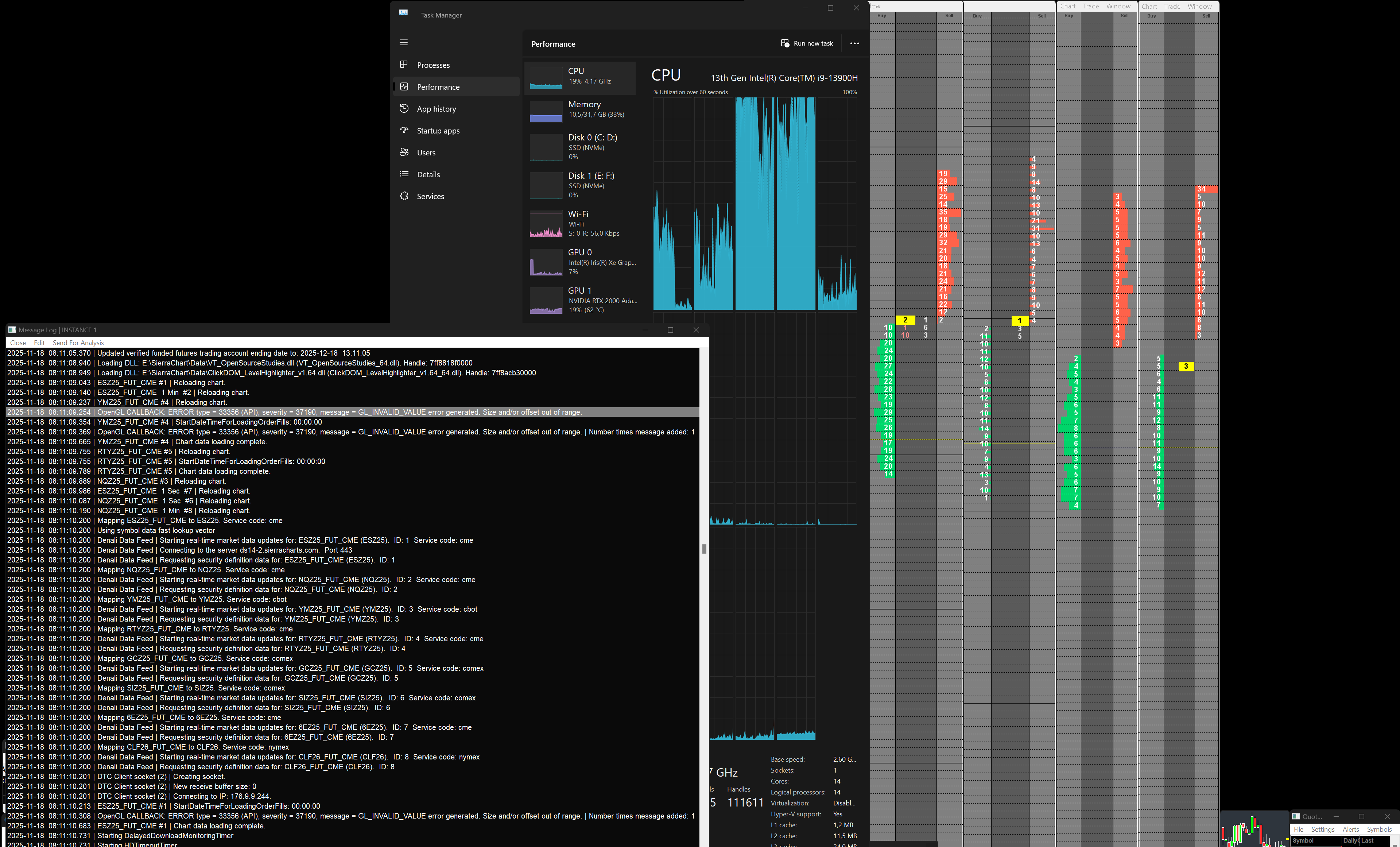

I had a similar problem recently.
I have a RTX 2000 with the 573.57 drivers, and 2807 version.
With OpenGL activated, the liquidity on my BID/ASK DOM columns were blinking black when I overed my mouse on the columns.
Also, my CPU utilization was increasing more and more with time, until using 100% of CPU utilization for the allocated cores.
Deactivating OpenGL fixed the problem completely.
I'm going to update my my drivers to 581.80 to see if it makes any difference.

I updated to 581.80, no change.
I opened a blank DOM, no studies.
The Bid/Ask columns are still blinking with OpenGL activated, and my CPU usage goes through the roof after a few minutes.
Same problem with with the compatible OpenGL setting activated.
The only solution for now is to deactivate OpenGL.

I updated to 2812 and activated OpenGL Debug output.
In the message log I spotted some errors at launch :
2025-11-18 08:10:56.748 | OpenGL enabled (NVIDIA Corporation/NVIDIA RTX 2000 Ada Generation Laptop GPU/PCIe/SSE2)
2025-11-18 08:11:13.452 | OpenGL CALLBACK: PERFORMANCE type = 33360 (API), severity = 37191, message = Program/shader state performance warning: Vertex shader in program 20 is being recompiled based on GL state.
2025-11-18 08:11:11.624 | OpenGL CALLBACK: ERROR type = 33356 (API), severity = 37190, message = GL_INVALID_VALUE error generated. Size and/or offset out of range.
Let me know if I can do anything more to help you diagnose the problem.
