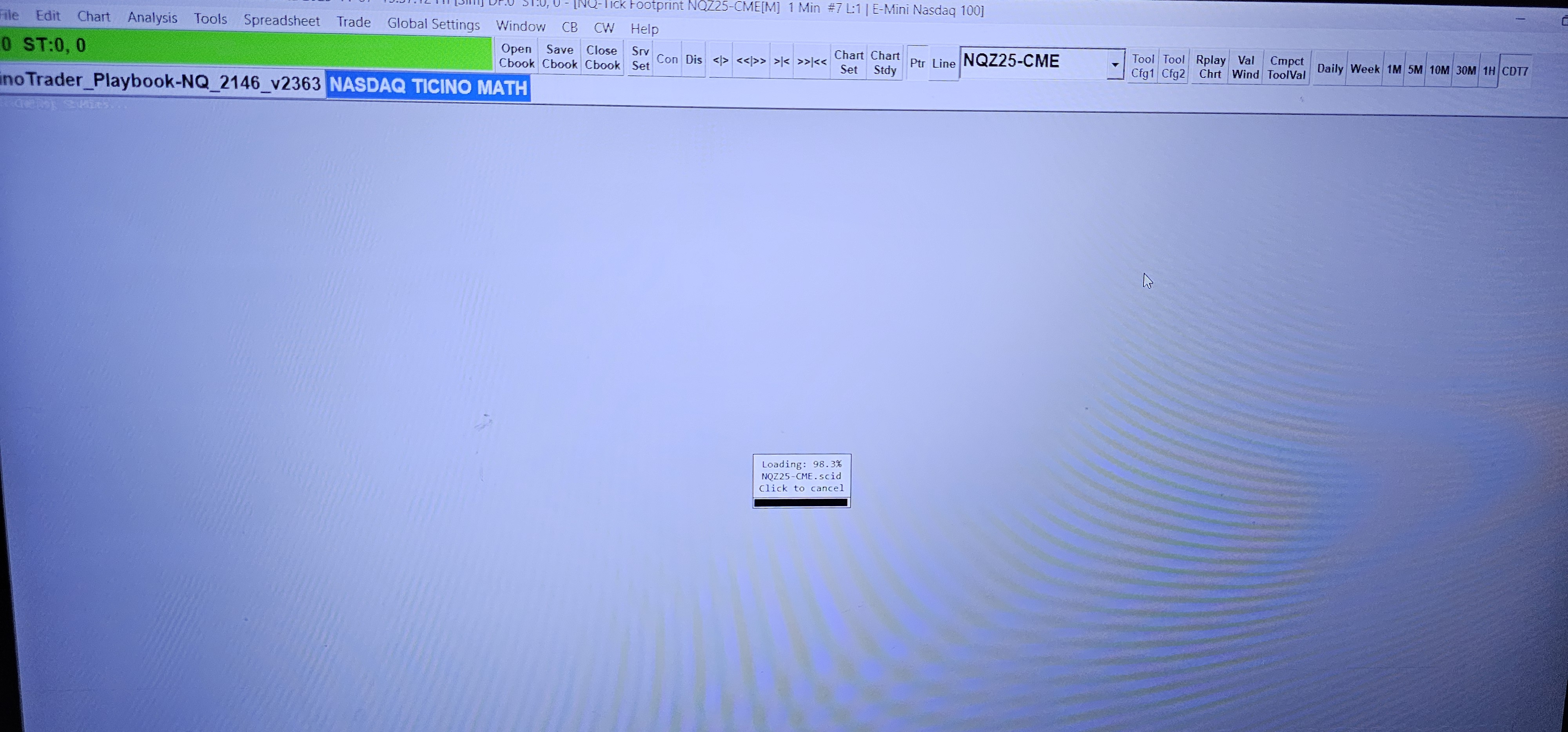

[2025-11-07 21:34:42]
User645382 - Posts: 10
Hello
Please see attached screen shot you had requested.
this happens every Min because I am using 1 min Chart
Please help
imageLoading or Refresh ISSUE.jpg / V - Attached On 2025-11-07 21:34:15 UTC - Size: 1.77 MB - 149 views
[2025-11-07 22:03:03]
John - SC Support - Posts: 47854
Have you gone through the items as referenced in post #4?

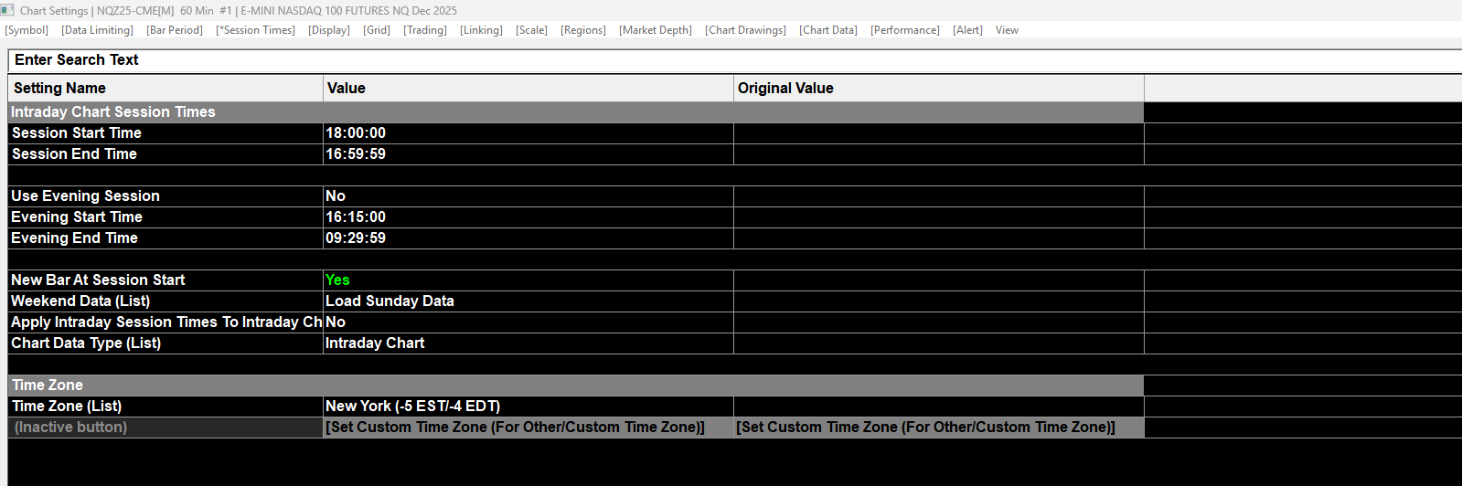

[2025-11-08 21:35:41]
Sierra_Chart Engineering - Posts: 24841
Go to that specific chart which is reloading and go to Chart >> Chart Settings. On the title bar of the Chart Settings window do you see "| RefBy:" . If so, what are the chart numbers shown after it?
Date Time Of Last Edit: 2025-11-08 21:36:55
[2025-11-08 21:55:58]
Hello John
Really appreciate your reply on the weekend, thanks a lot
Pls see attached sc i dosn see RefBy anywhere
imageChartSetting SC.png / V - Attached On 2025-11-08 21:54:34 UTC - Size: 41.68 KB - 122 views
